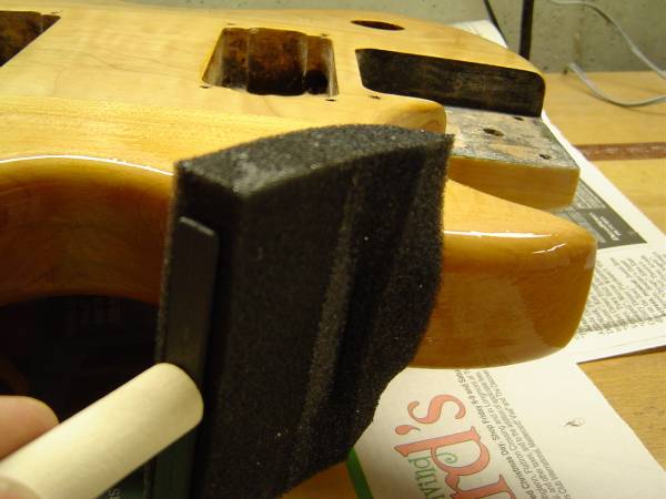

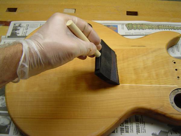

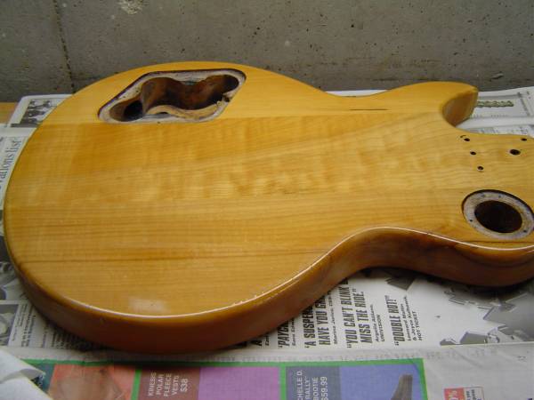

Here are some shots of me refinishing an electric with KTM9 and brushing it on. Here I am using a cheap foam brush with good results. As you can see there is good flow out. Once youput it on, leave it alone. Try not to go back and rebrush it. You can pretty much follow Mike Doolin's finishing schedule even if you brush it on.
Mike Doolin finishing schedule
Robbie O'Brien38540.6366550926
